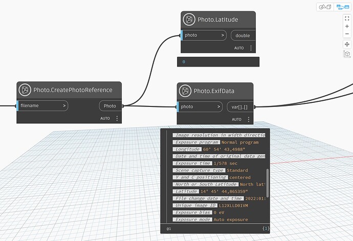

Hi @Anton_Huizinga, I’m having issues with this. ExifData works, but Latitude and Longitude gives me 0, while Location says my photo does not contain location. Any idea ? Thank you so much for your help !

No it did not. Now the “Location” node gives me a result but it is way off and the result is always the same with any picture. And “Latitude” and “Longitude” nodes gives me 0 everytime.
I think there is still something I’m not using correctly here.

But anyway, I guess your Exif is not correct. If I enter the Lat and Lon in Google, I get a location in Martinique:
I was not sure about the W, if I enter E then the location is in the middle of the ocean.

Yes, this is another picture. I tried with one in France, and one in Martinique so the coordinates you have are correct. The pictures are made with my Samsung phone and there are not that many parameters I can change. And pictures are placed correctly when I add them to maps in my Phone. FYI, here is the GPS data stored in the church photo I shared. This one is in France in a city called Provins.

The only thing I can imagine is an issue with the conversion of numbers. I see you have commas in the seconds, in my case it is a point:
I’ll have to test with it to be sure, I’ll let you know.
Hi, so I just changed the windows parameter from “,” to “.” and it works. That was the issue :partying_face:
