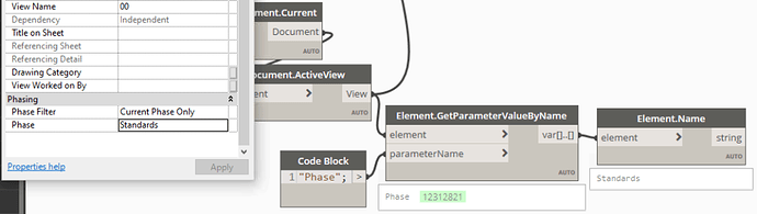

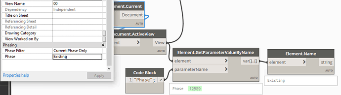

Anyone know why this happens? Why does it behave differently with the Proposed phase?

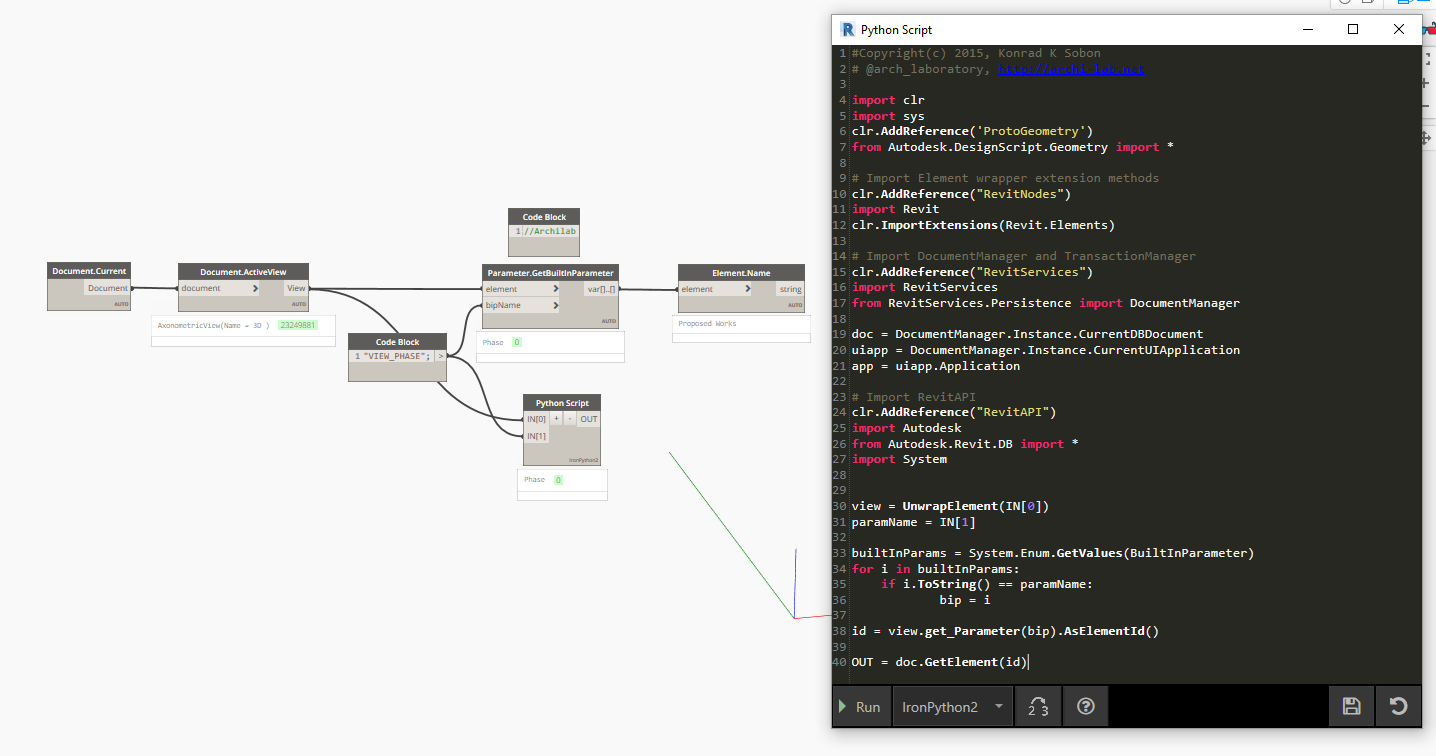

I think this is likely to be because when pulling parameter values ā€˜by name’ there can be duplication in the names.
I would try and pull the Phase by ā€˜built in parameter’ I think there is a node in Archi-Lab… This is more robust.

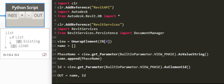

Thanks :slight_smile: I wrote some Python that seems to have fixed it but I was wondering if this is normal/ why it does it etc.

Hey,
Hope this helps…
Cheers,
Mark
#Copyright(c) 2015, Konrad K Sobon
# @arch_laboratory, http://archi-lab.net
import sys
# Import Element wrapper extension methods
import Revit
import RevitServices
app = uiapp.Application
# Import RevitAPI
clr.AddReference("RevitAPI")
import Autodesk
import System
view = UnwrapElement(IN[0])
paramName = IN[1]
builtInParams = System.Enum.GetValues(BuiltInParameter)
for i in builtInParams:
    if i.ToString() == paramName:
			bip = i
id = view.get_Parameter(bip).AsElementId()
OUT = doc.GetElement(id)
You will note that this python is written to work with View Phases, other parameter values may not return an ID, which is why the archilab code accounts for various storage types:
https://github.com/ksobon/archilab/blob/master/archilabSharedProject/Revit/Elements/Parameter.c

This is what I wrote btw:
I only need the name OR the Id (as long as I got the same output for each phase) so I went with the easy option. :slight_smile:
I’ve just added the ID thanks to your code (I couldn’t find the bit in the Revit API for Id before)

The why is pretty clear. The how is another issue. The Value out of the Element.GetParameterValueByName returns a var. So, a parameter might be a string, an integer, etc. Two of your phases are being returned as a phase element. (Revit.Elements.nknownElement) The phase in question is being returned as a String.
Honestly, I would have expected all of the Phase parameter to be returned AsValueString since you are starting with the view element, rather than a phase element. Typically, you would specify AsDouble, AsInteger, AsString, AsValueString or such. So, I think there is a bug in the node that isn’t parsing the value to the correct type. Returning an element from a parameter value would be a non-typical thing to return - unless the node were to look at the Storage Type. Or rather with the current release of Revit,the ForgeTypeId.
I think the question is how the node is parsing the input to determine the correct var output type. In this case it is unpredictable - at least in this file. I haven’t been able to replicate the issue in other files with Revit 2023.

I want to know why the, ā€˜Element.GetParameterValueByName’ node sometimes spits out a string.
That’s what I’m asking. It is a very odd glitch!
Without seeing the code behind the node - hard to say. Revit has a lot of elements and parameters. I’m guessing this node is written to parse standard user defined parameters that fall into easily determined type categories. The node probably needs an input so you can manually force the correct data output rather than var. With var - you are at the mercy of the node’s code.
You’re on a version of Revit as ForgeTypeId was becoming a thing. This is one of those programmatic things that ForgeTypeId is trying to clear up.
how long has this file been around? It could be that this element is from a very old version of Revit and something is not quite right under the hood. This Phase has an element Id of 0. I think that is unusual. If I get rid of this phase (merge with previous) and replace it with a new one - the problem goes away. And I haven’t been able to recreate the issue with other files in Revit 2023. So, something about that particular phase and the node are not playing well together.
