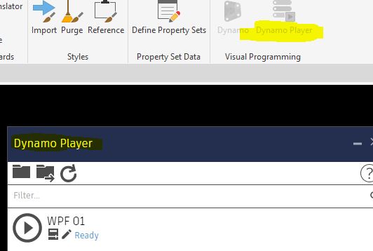

Try to work through
AeccLaunchDynamoPlayer
1
Before I try this I would like to now why @hosneyalaa you suggest this? Is dynamoplayer faster than using dynamo itself? To my experience it is more cumbersome to use dynamoplayer when debugging…?
