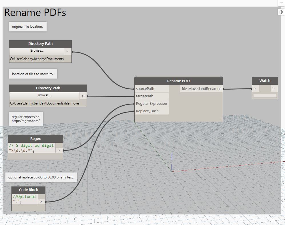

I’ve added a PDF batch Renamer which uses Regular Expression to strip out your sheet names. I got it up on the package manager earlier this week. Its named "Rename PDFs under Parachence package. It’s one of my first attempts to create a package and upload it. Please let me know if I can add additional features or something needs improvement.
Here is a website to help with Regular Expressions
Here is a quick video I made of how it works. Video
RenamePDFs.dyn (6.0 KB)

I added ability to rename DWGs. Makes me wish I could rename the node. O-well. I found a small bug and fixed it as well on this new version.
The git is located here: https://github.com/dannysbentley/RenamePDFs
