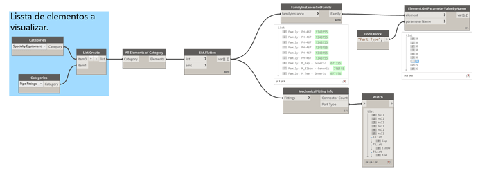

I been trying to get the values from the parameter “Part Type” in “Specialty Equipment”, I tried “MechanicalFitting.info” from MEPower but its only working with “Pipe Fittings” also tried “GetParameterValueByName” but nothing. Any help?

From the project, because I need to get the same parameter from Pipe Fittings, and others… that´s the point we don’t want to open all the families for check that info.
It’s a parameter of the family. You need to get the family from each instance and then query the Part Type parameter.
Nick, I’m at this point:
How can I turn the numbers into the string I need?
Thanks.
It looks like the lower node is returning everything correctly. The numbers you are seeing are the indexes of each of the members within the PartType Enumeration
The first 6 numbers in your list are 0, which corresponds to the first item in the enum (“Undefined” in this case). Likewise, the member at index 9 is “Cap”.
Your “Part Type” for the specialty equipment family says “Normal”, so the number should actually be 1 instead of 0, but I’m not sure why that isn’t the case.
It seems that “Normal” and “Undefined” corresponds to 0 and them DuctMounted starts in 1, that explain why Cap is 9 and elbow is 5

It may be that Undefined is -1 and Normal is 0. The MechanicalFitting.Info node is probably returning null values because your Specialty Equipment families are not duct or pipe fittings. It should be rather easy to get a node to return “Normal”, but it will most likely have to be done in a Python node using the Revit API. I can try to do some testing tomorrow.

MEPover has a node GetParameterAsValueString which will return the user-facing value instead of the corresponding number.
oh god…it works … I was cheking with a big list XD, but this way is better.
