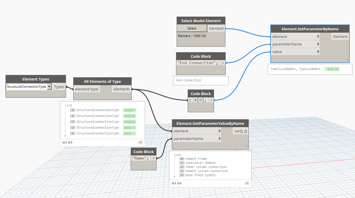

The storage type for that parameter is ElementID.
It is expecting a connection “Element Type” refer below.

Something like this?
Logic = Filer Elements where Start Connection equals Moment Connection
