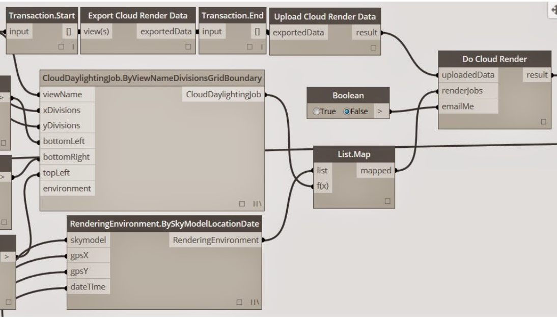

What are the most suitable packages for Daylight analysis?? I have seen some works but I can not find related packages, or any other ways as alternatives.
I want to do daylighting analysis based on this above Model but i couldnt find more than half of the nodes, can some body tells me alternatives for these nodes?
For example, how can I choose Perez Sky Model in Dynamo?
There is a solar analysis package which may do what you are after. You can also use vasa for shadow studies.

Thanks for your answer, I have tried to install the “Solar Analysis For Dynamo” package but nothing does show up. Now I am stuck in this daylighting analysis.
Maybe, it is because of the version of Revit 2022 and Dynamo 2.12 that I use, as I read the Daylighting workflow packages are no longer supported in Dynamo after Revit 2019.

Many thanks for your help, I will try to replace the workflow nodes with the solar analysis package nodes.
