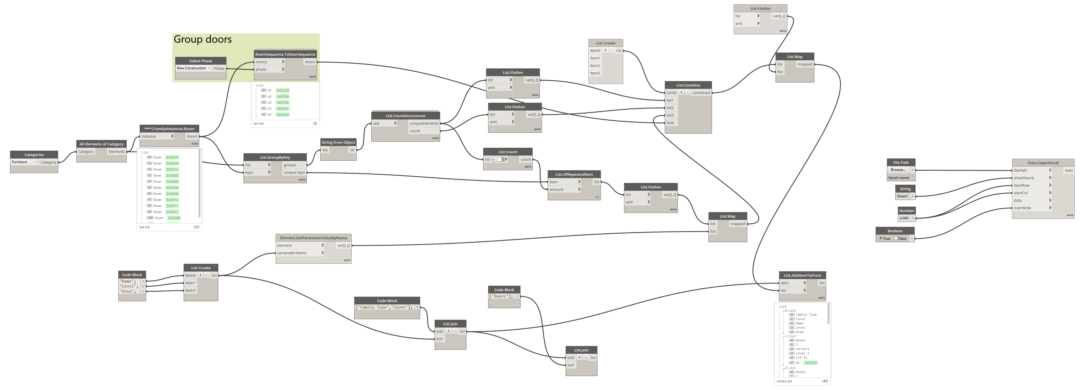

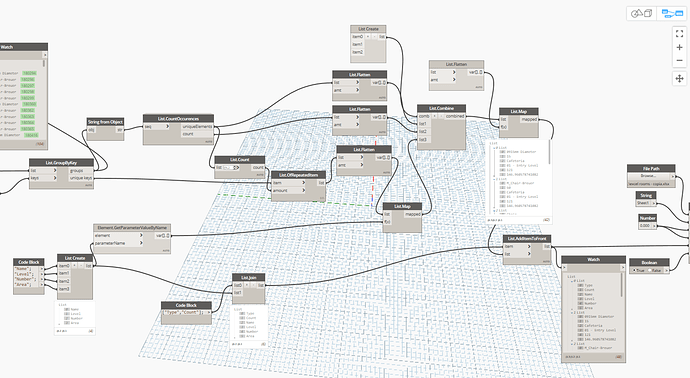

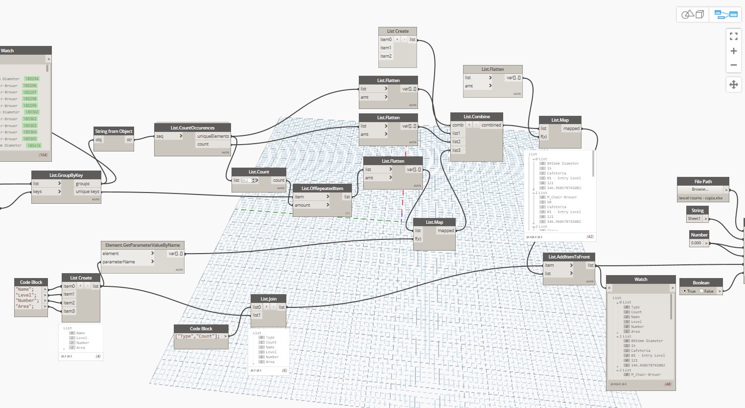

There must be a more elegant way of doing it… anyway, it works

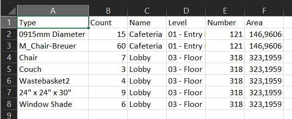

excel output

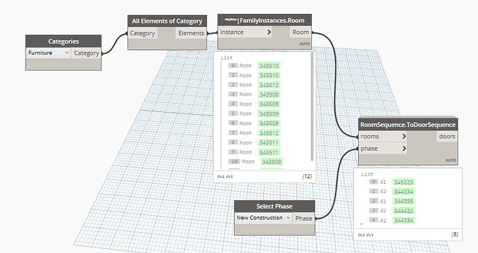

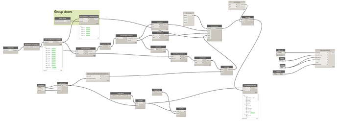

Hi, @m.souza I am trying to add doors to list but I have issues
room test excel.dyn (53.8 KB)

I’m not quite sure what problem you’re facing and I can’t run your node right now, but looking at the image you uploaded I see you have to add one more item on the list.create node connected to the list.combine.
Let me know if there is any other issue with your graph.
