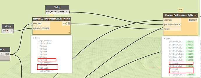

This is my original problem: There are three doors with no Room on the other side, so these values are null in the Room name list (a list of Strings). SetParameterByName DOESN’T EXECUTE on these indices of the list, so there are three null Doors in my final door list (even though the input Element list is complete with no nulls). The parameter values of these doors are not changed.
The ReplaceNull custom node allows for replacing the null references with a string. The SetParameterByName node executes correctly for all doors since there are no null values in the input list.
