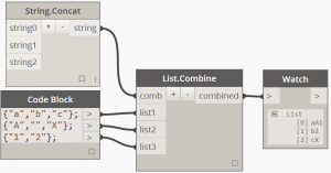

I got an issue about list. Combined. What I want it do is, to combine the value from different list to one value.
fx:
List 0
[0] A
[1]B
List 1
[0] A
[1]
Gets into
List 0
[0] AA
[1]B
It works ok with two list´s but with more, it only shows “null”
I make an example here Intersection, where I have solved the issue by combined the list combined, after east odder.
Hope you can help me to optimize my scripts, so that it takes less processer power to run.
