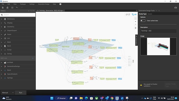

I´v tried to use it in dynamo sandbox, the only error was to use pyhton 3. I´ve changed but I still have the same error in refinary.
I´ve simplfied the graph (manteinig the logic) and managed to create the image (the graph in refinay gave me the same problem.
Image isn’t readible. Can you zoom in on the nodes so names are legible, and export again?
