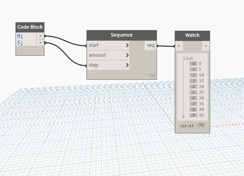

Can you guys point me out a formula? A number sequence, it has to begin with number from 0 to 45 has a 5 step, and if it comes to 0 or 45 it will continue decreasing or increasing. It’s like 10 15 20 25 30 35 40 45 40 35 30 25 20 15 10 5 0 5 10 15 etc.
Something like that will do
Froom there Reverse the list and add them
Yes, I got there too, but how do you return from 45 to 0 back again?
Like that?
Yes, but I want to begin with a random number not 0 or 45 but maybe 25 or 40, it has to know that the sequence goes backwards when reached 45 or 0
