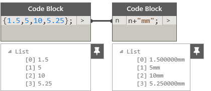

Great Topic! THANKS to everyone! How about suffix? for example, how to add “mm” to a list 9, 12.7, 3, 2.5, 5, 7, 1.25, make a new list 9mm, 12.7mm, 3mm, 2.5mm, 5mm, 7mm, 1.25mm?
I found a way below, is there any better one?
Ignoring the trailing zeros on converting to a string.
Adding a suffix…
