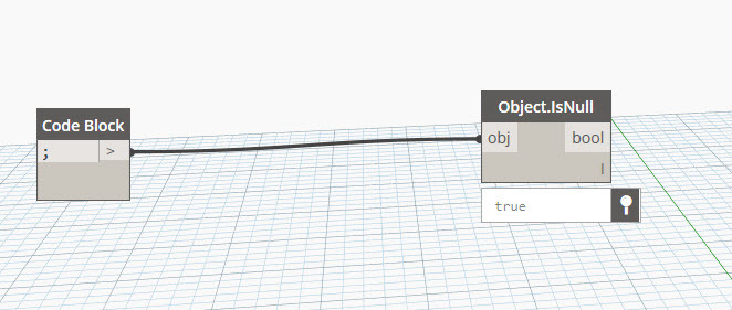

There’s this guy too, Object.IsNull but it only gives a true/false output. Can pair it to a list and split your results.
