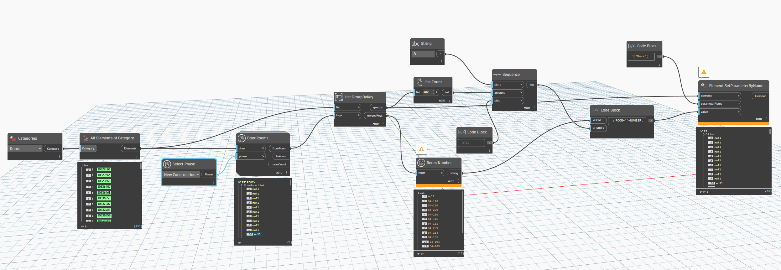

Null output from Dynamo (Revit 2024) Door.Rooms
I am trying to get the “from room” and “to room” values from my doors, The clockwork package seems to have the Node I need (Door.Rooms) how ever I seem to be struggling to get the node to work. I am in Revit 2024.
I have tried changing the Phase also
