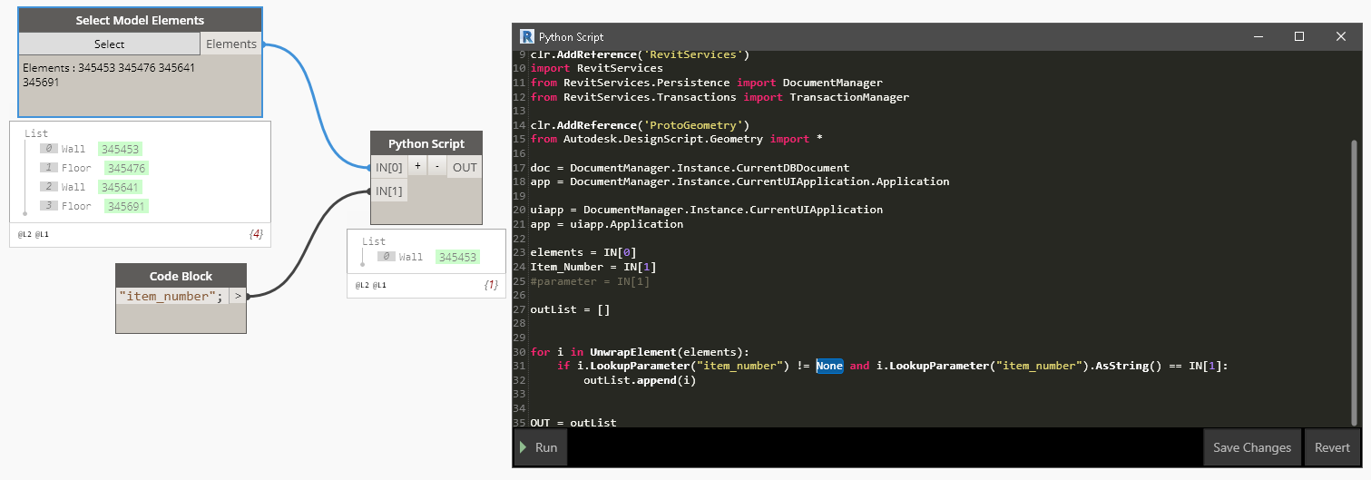

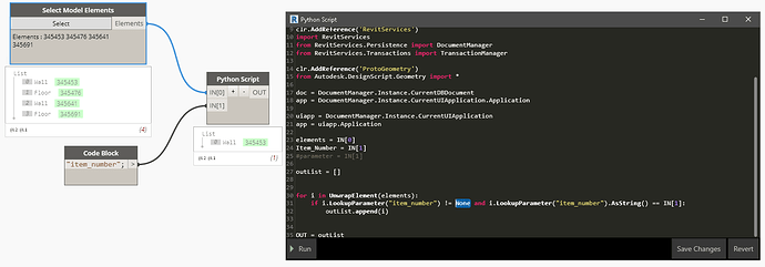

@shujath36 append the LookupParameter("Item Number") to the output list, check what is the value of the greyed out ones, filter them out according to the value you got, basically, you should end up with clean elements ready to be filtered out according to the “IN[1]” value:
Thanks for that valuable input. Now I don’t have to bother about those equipment which does not have parameter added in it or having null values.

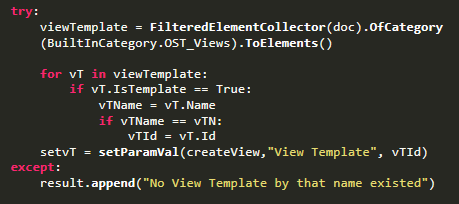

Another method you can put in there is a try/except clause
This makes it so it tries to do it, then if it doesn’t exist skips to the next element.
