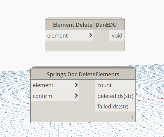

Here are some alternatives from DanEDU package and Springs package:
I just saw those. Thanks for the help. I’ll try them Monday.
Thank you.
