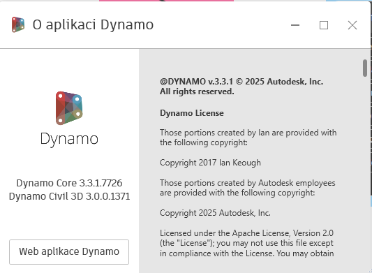

Version of Dynamo:
I works quite well except one thing. If I close .dyn file with some node from my plugin and then reopen nodes in from my package have duplicated input and outputs. See image below.
