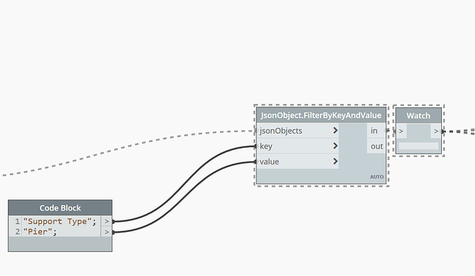

I’m busy reading in json files and need to traverse through it using the JsonData package.

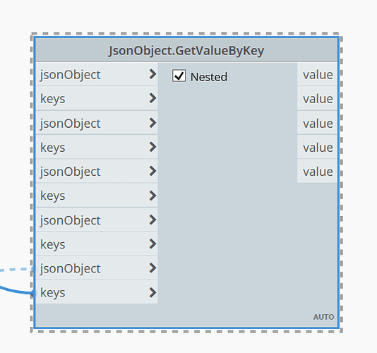

When I close and open the script, the number of inputs and outputs on this node duplicate, and it needs to be replaced with the same node. This is happening every time I open the file.
See below bottom node showing the duplication, and the same node above.
this file has been reopened 4 times

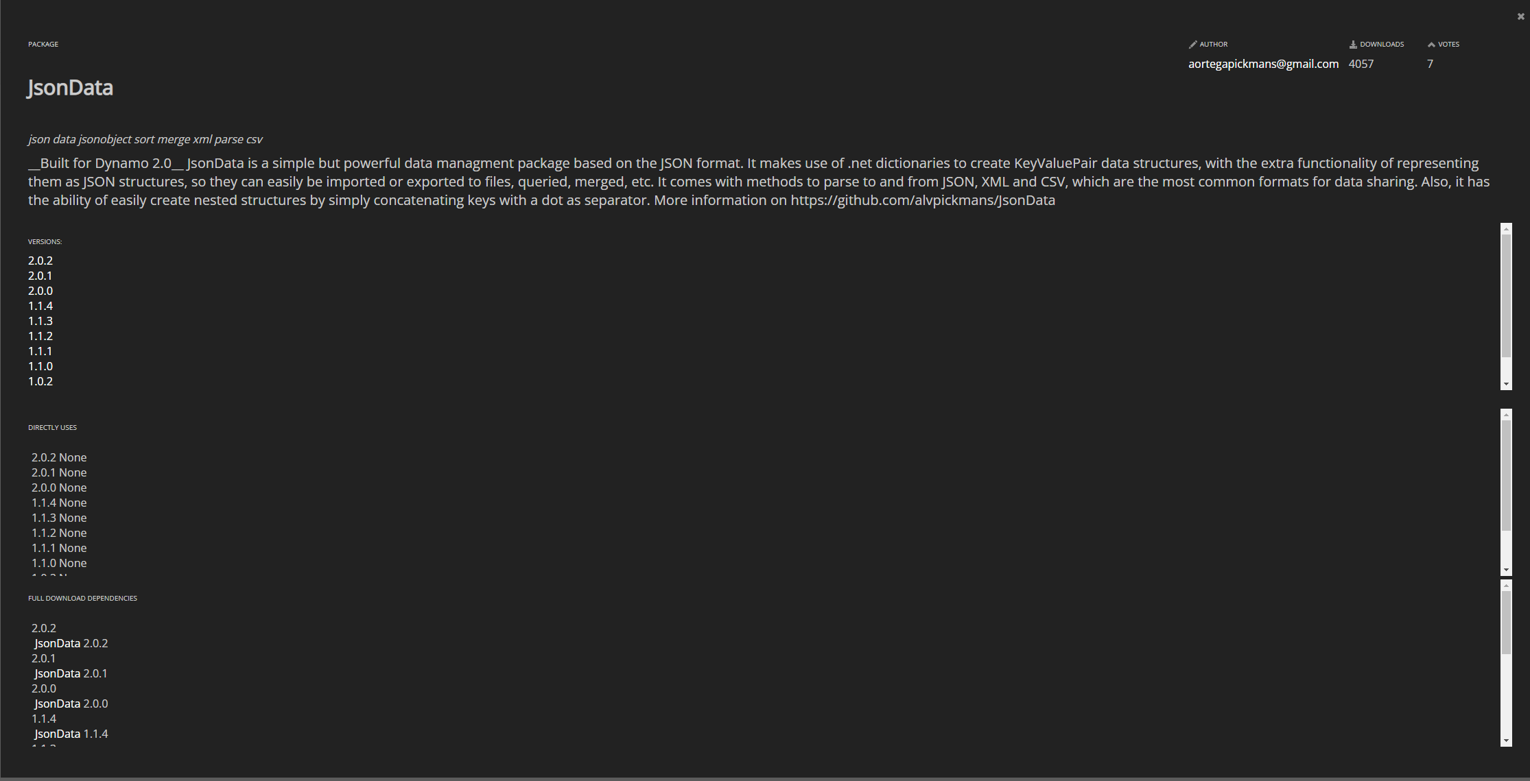

Have you seen this post?
Thanks for this Marcel,
It is probably a similar issue, so I am assuming the package owner for JsonData needs to revise their versioning.
What version are you using?
