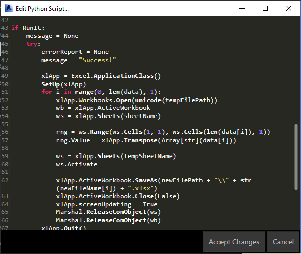

I’m trying to export data to Excel by using New File By Template but it doens’t work. I get a Traceback at line 54. Does anyone knows how to solve it?

Inputs “dataSheetName” and “templateShettName” must be the same?
And why I put “Nouveau” in “newFileName”, Excel file created is only called “N” (first letter of string)?

The input for data seems to be string and it’s look like you have to provide as much filenames as strings in your list of data input.

that’s what I finally understood. But this is not my desired use, so I think I will do differently
