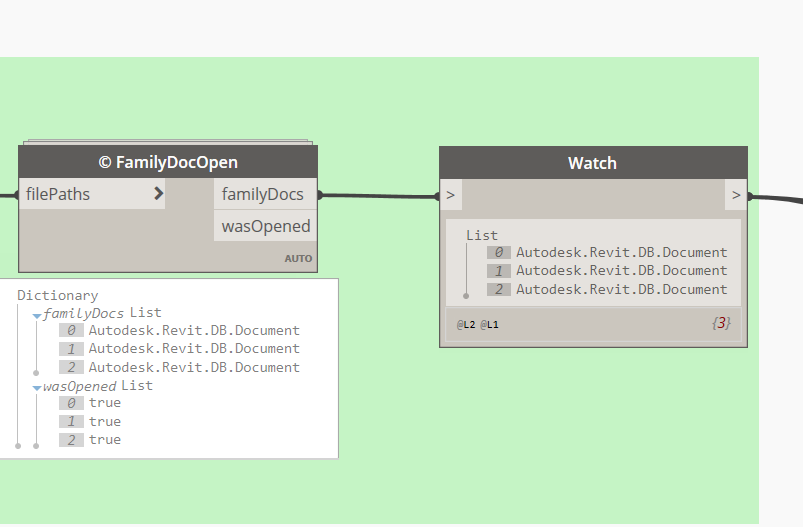

Hi all,
Is there a way to get the nested family’s from a familydocument?
I use the Crumple package to open the family’s in the background.

or a bit of python
def nested_fam_name(doc_fam):
doc_family = doc_fam.Document.EditFamily(doc_fam)
print (doc_family.Title)
for i in families:
nested_fam_name(i)

This is my end goal, I want to collect my nested family and set in all those documents the parameters.
Any thoughts?
Probably not easily done without some advanced Python given you’re dealing with statements of variable depth (it would have to either be a while loop and/or a yielding function to my understanding).
As families are opened, they would need to be told their containing family for reload, and the same Python block would ideally add parameters and track the level of depth they sit at.
A simple for loop could then iterate across the levels of nesting in deepest first, then reload back in later iterations. The family to be reloaded to would need to be available, so tracking the depth of nested families is key.
