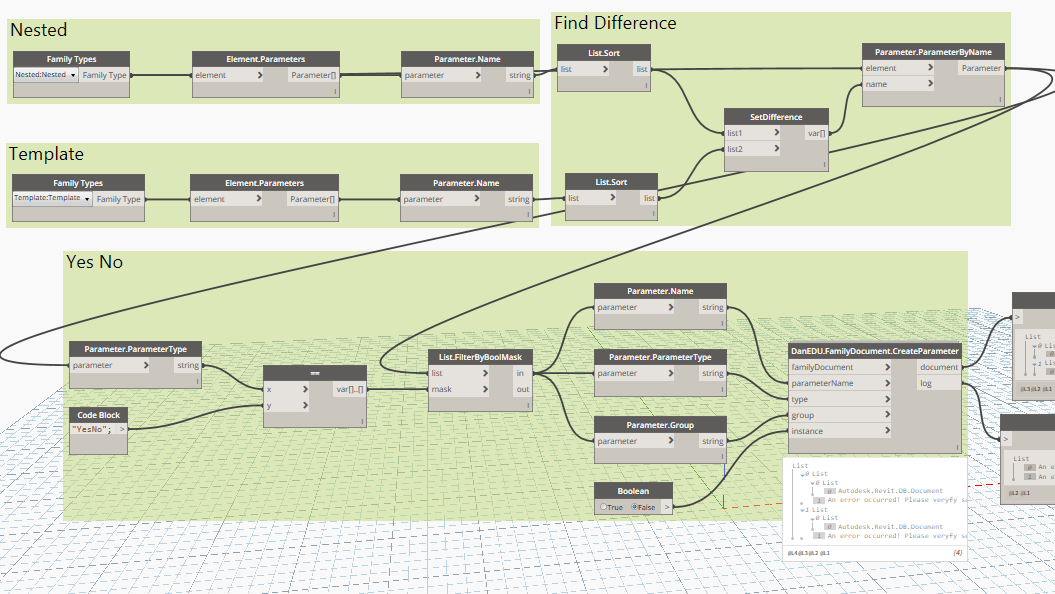

So I know there is a lot of Shared Parameter discussions out there and adding those parameters, but they never quite did what I want. So with a big shout out to the DanEDU creator for his DanEDU.FamilyDocument.CreateParameter Node here is what I’d like to share.
I wanted to create all of the parameters from a Nested Family into the current family. I do a lot of nesting for Windows and Arrays etc. I set up a Template.rfa with no changes. I then loaded that and a Nested a family in to a new family. Using SetDifference I can show the user created parameters from the Nested Family compared to the Template.rfa. Then a Filter by Booleen mask and hey presto the DanEDU node creates the Parameters.
I setup my script for the parameter types Length, Number, Material, Yes/No and Text.
I’m sure this could go further than I’ve taken it. Anyone got any idea how to associate a family parameter?

The idea is bascially for Windows. I have a pane (started as a generic model, changed over to a Window) with a bunch of types and options, casement\awning, materials and dimensions. I nest this pane into a new window family and then create my configuration and assign the parameters, which was a lot of typing! I can now create those in seconds based on what parameters the nested family.

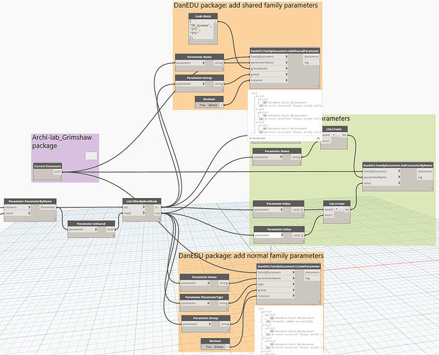

Hi @Matthew.Pettengell,
Does the below workflow suit your needs?
Copy parameters from nested families_v01.dyn (25.5 KB)
It’s a rough setup of what (i think) is your goal, but it needs further improvements.
  • The “parameter groupname” of the shared parameter list is added manualy (at this moment i don’t know how to get these values in an automated way).
  • I’m not sure if the DanEDU nodes can handle multiple values as “group” input (in my tests the shared parameters were not always placed in the correct parameter group).
I hope it points you in the right direction.

I wasn’t actually looking for adding Shared Parameters, but good work. It also appears you have a different workflow for parameter type, does this actually work for a list of different parameter types?
This post was more to help others that don’t require Shared Parameters or Excel to get some normal parameters working.
