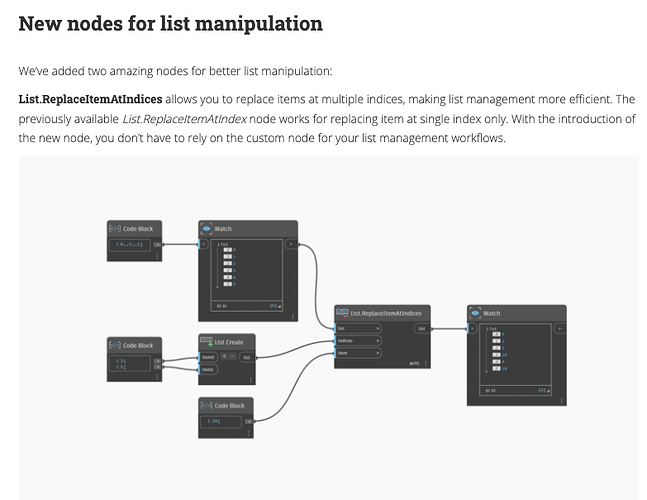

Historically there has been a limitation in this node to only replace at a single index; but from Dynamo 3.5 onwards there is a new node out of the box that does exactly what you are looking for :slight_smile:
Dynamo Core 3.5 Release - Dynamo BIM
