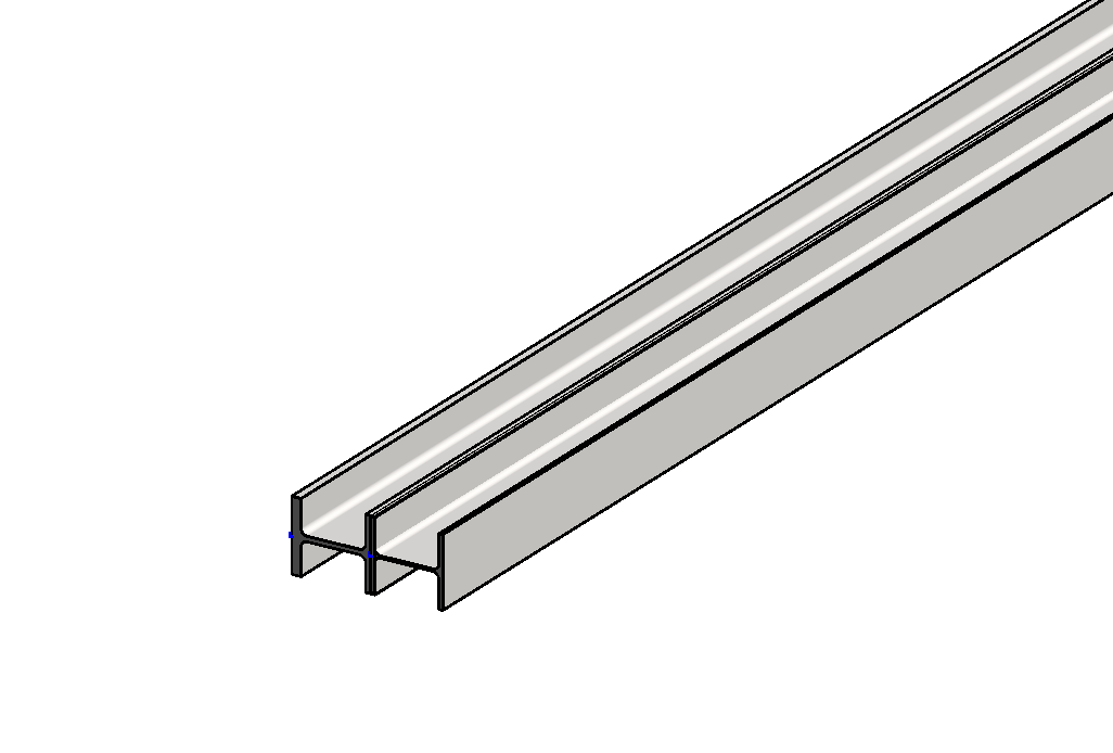

Now my only problem is to rotate that beam around X-axis?
Can you guide me?

Been trying to figure out away to control the orientation of a structural beam in section relative to a specific surface/line (green)? I use the âStructuralFraming.BeamByCurveâ node on a list of lines to generate the beams, but no luck in controlling a rotation angle around a beamâs axis.
See images below:
[purlins]
[purlins 2]
