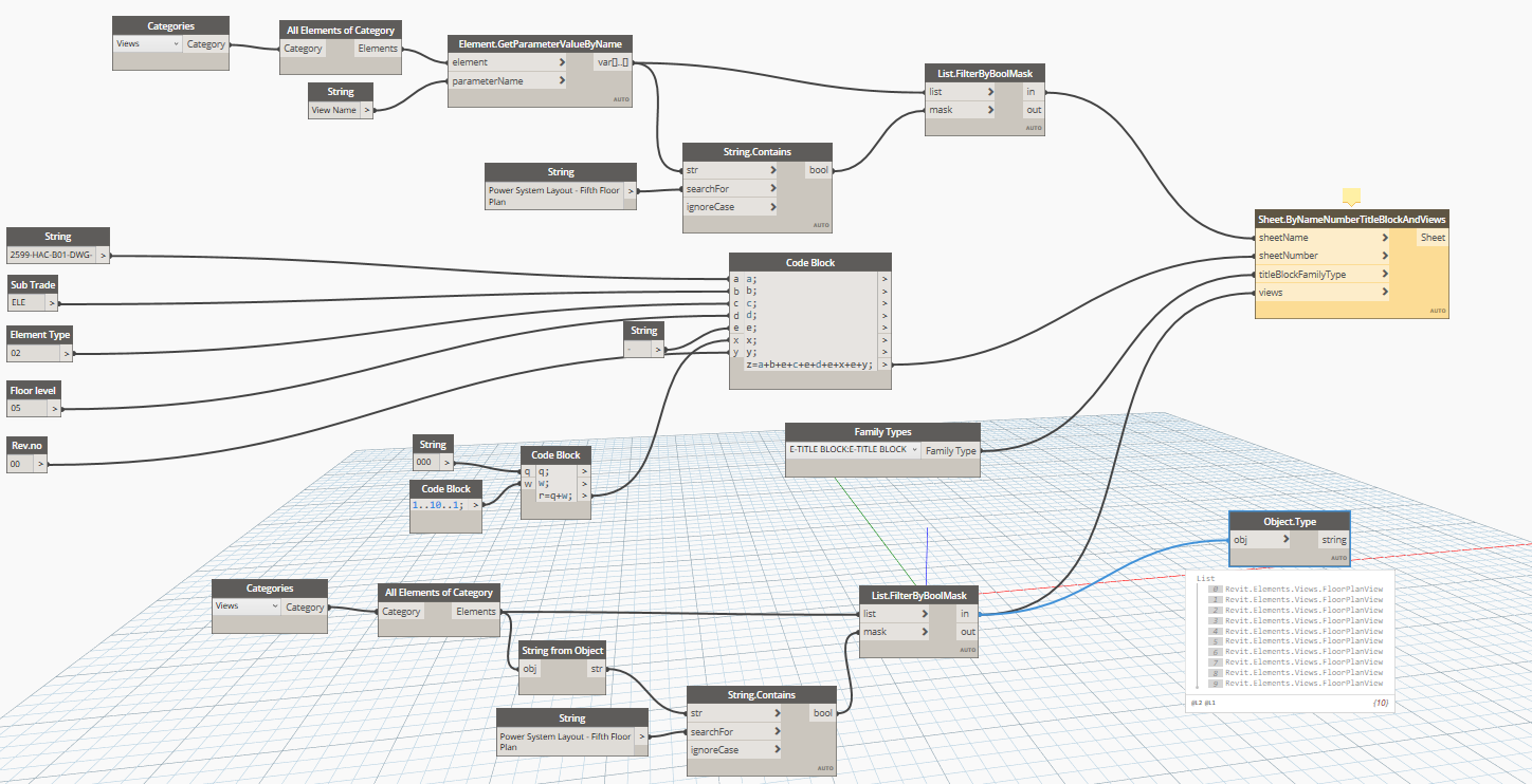

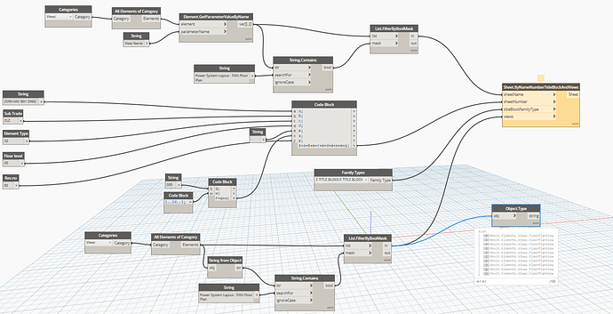

my script is made to create 10 sheets at a time with specific name and number and it did so but an error comes up for adding the views and all the sheets are empty
that is the warning message that appeared
Warning: Sheet.ByNameNumberTitleBlockAndViews operation failed.
View 0 could not be packed on the Sheet. The sheet is 3.90091863517061 x 2.75918635170607 and the view to be added is 7.32939632545932 x 7.13409033243936
