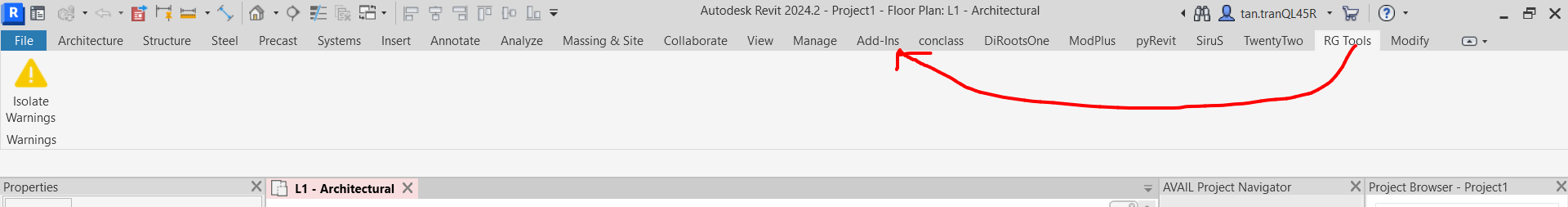

I just want to ask if there is any way that I can edit the plugin and move its ribbon into the add-in tab, just to make it more compact for user interface, especially when I am having lots of plugin installed. Does anyone have any idea about that?
Not sure what is meant by this, but I can try to shed some light:
Code developed in C# is owned and maintained by the developer, not consumers of their tools. That isn’t a Revit thing but a C# thing as .dlls are pre-compiled as opposed to compiled at runtime the way scripting environments are (Python, Dynamo).
