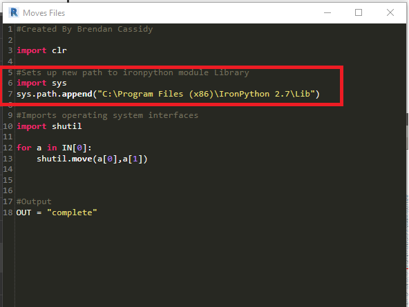

@Kieran_Atherton, I think this might be to do with how dynamo now loads python modules since Dynamo 2.1. This is because you do not have to append the iron python module folder from this version on wards.
Eg line 7 in this example:
Try this version which i have removed all of the ironpyton lib folder appends from any python nodes.
Archive Old Versions(dynamo 2_1 or above).dyn (42.4 KB)
Brendan,
I still seem to be getting the same python error:
File “”, line 13, in
File “C:\Program Files\Autodesk\Revit 2020\AddIns\DynamoForRevit\IronPython.StdLib.2.7.8\shutil.py”, line 316, in move
File “C:\Program Files\Autodesk\Revit 2020\AddIns\DynamoForRevit\IronPython.StdLib.2.7.8\shutil.py”, line 144, in copy2
File “C:\Program Files\Autodesk\Revit 2020\AddIns\DynamoForRevit\IronPython.StdLib.2.7.8\shutil.py”, line 97, in copyfile

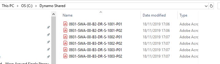

Also, this is the test folder with the files I am trying to archive in the image below:
Worth a try but the box in the dynamo script with the text “Archived”, create a sub folder called “Archived” in that folder then run it.
Apologies Brendan, I must of missed that part. The script is brilliant !
