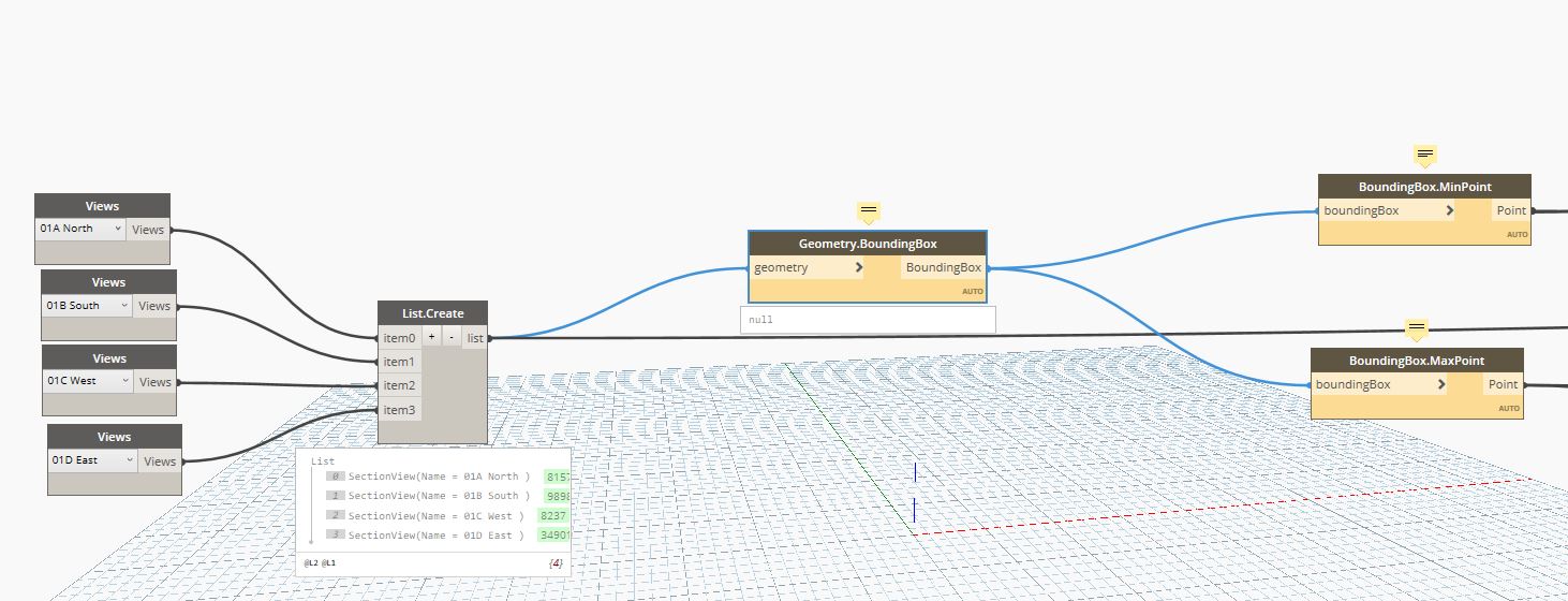

I am migrating from 1.3 to 2.0… but have some problem with one of my scripts.
Script works fine in 1.3 but get’s an error in 2.0 and have no idea how to solve it.
the error is:
Warning: Geometry.BoundingBox expects argument type(s) (Autodesk.DesignScript.Geometry.Geometry), but was called with (Revit.Elements.Views.SectionView).
