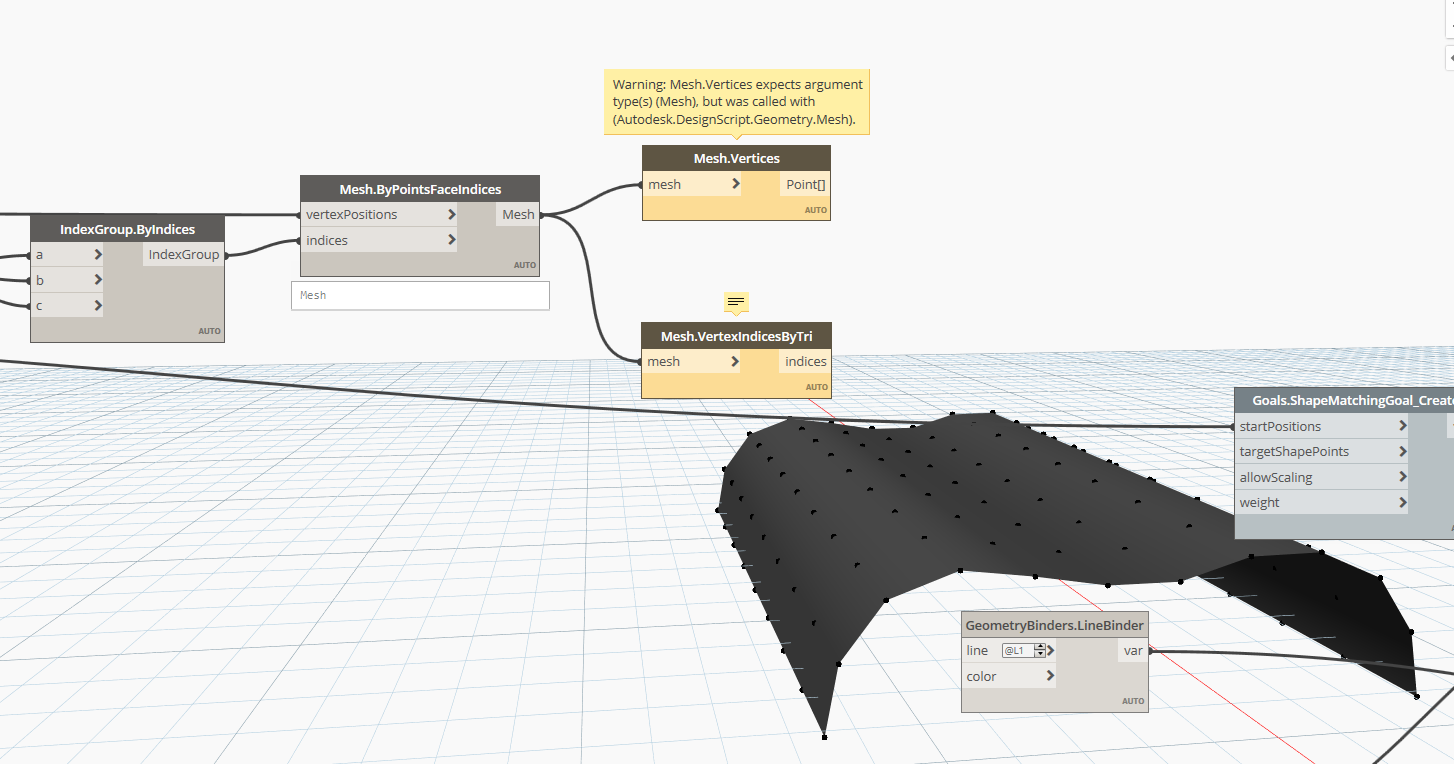

I created a mesh using the Mesh.ByPointsFaceIndices node from MeshToolkit package.
However, now that I tried to get the vertices and vertex indices using nodes from the same package, it gave me this error:
Any ideas?

Springs node has a node called toolkit mesh to convert to Mesh
Hey,

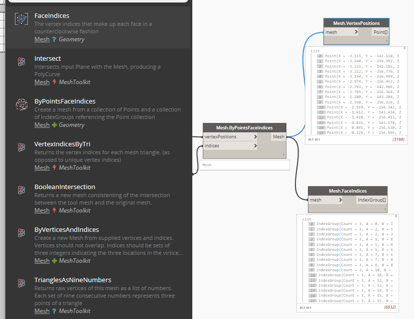

Mesh.ByPointsFaceIndices isn’t part of the tookit, it’s just part of Geometry… Dynamo also has vertices positions and face indices, if these are what you need?

Edit: I believe that the Toolkit Mesh is more sophisticated than the version that Dynamo uses, though @Kulkul knows inifinitely more about it than me. You’ll find yourself swapping between the 2 a bit
