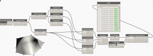

Hi Chris,
I’m not sure but I think that revit generated meshes are limited to 3 corners. Are you importing your mesh from a different source? Anyway here’s a basic example on how to map a 3-point AC to a revit topo surface with the default nodes:
If you’d like a DS example, just search the forum for “polysurface from topography” and you’ll find quite a few.

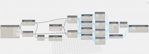

Hi Dimitar,
Thank you for the example, I am trying to bring a mesh from Rhino in via 3 or 4 point adaptive family depending on the mesh.
I have recreate the example provide but I believe the nested Lists are causing issues.
I am no Rhino expert, maybe a mesh is the wrong item to bring in… I know this can be done, still finding my feet in Dynamo, normally a C# programer…
Regards
Chris

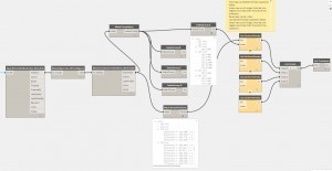

Chris, you will need to use the List.Map node
The screen grab and file below might help you understand better.
File: mesh.dyn
