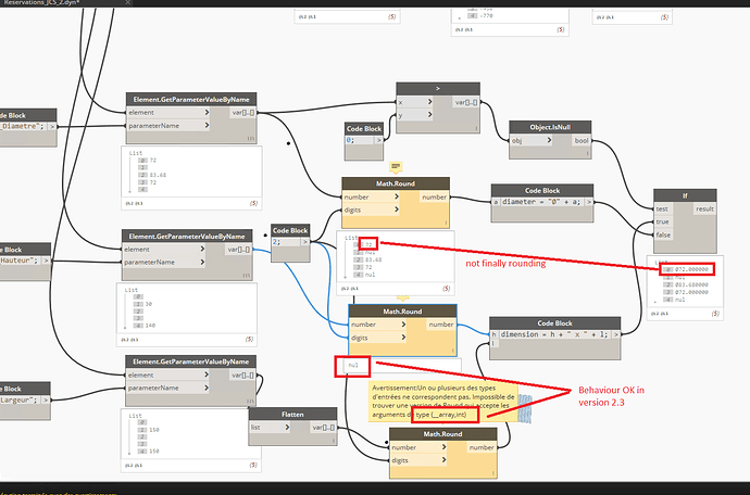

I’m trying to round some numbers using the Math.Round node. It has an strange behaviour (see attached image).
Does anybody know why is not working or another way to round a number?

This is all expected behavior. Your lists all have nulls or empties which is why you’re getting warnings. Rounding converts your values to doubles and then converting them to a string shows the trailing zeros (that are otherwise hidden). Using Math.Ceiling or Math.Floor converts the values to integers so there are no trailing zeros. If you need to keep 2 decimal places then you’ll have to remove the trailing zeros after the fact. I believe there are some custom nodes that already do this but I can’t remember which. A very quick python script would work as well.

I did more or less the same but this python node doesn’t work with empty values. So I had to add a dummy node to deal with “blank” values. What are these “blank” values, empty values?
