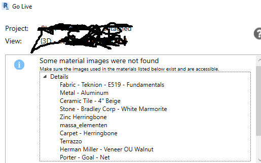

Seems like Dynamo would be a good tool to find missing Material images. Since Revit Live can tell us whether an image is missing, that must be accessible by the API.
Any clues on how we may do that?
