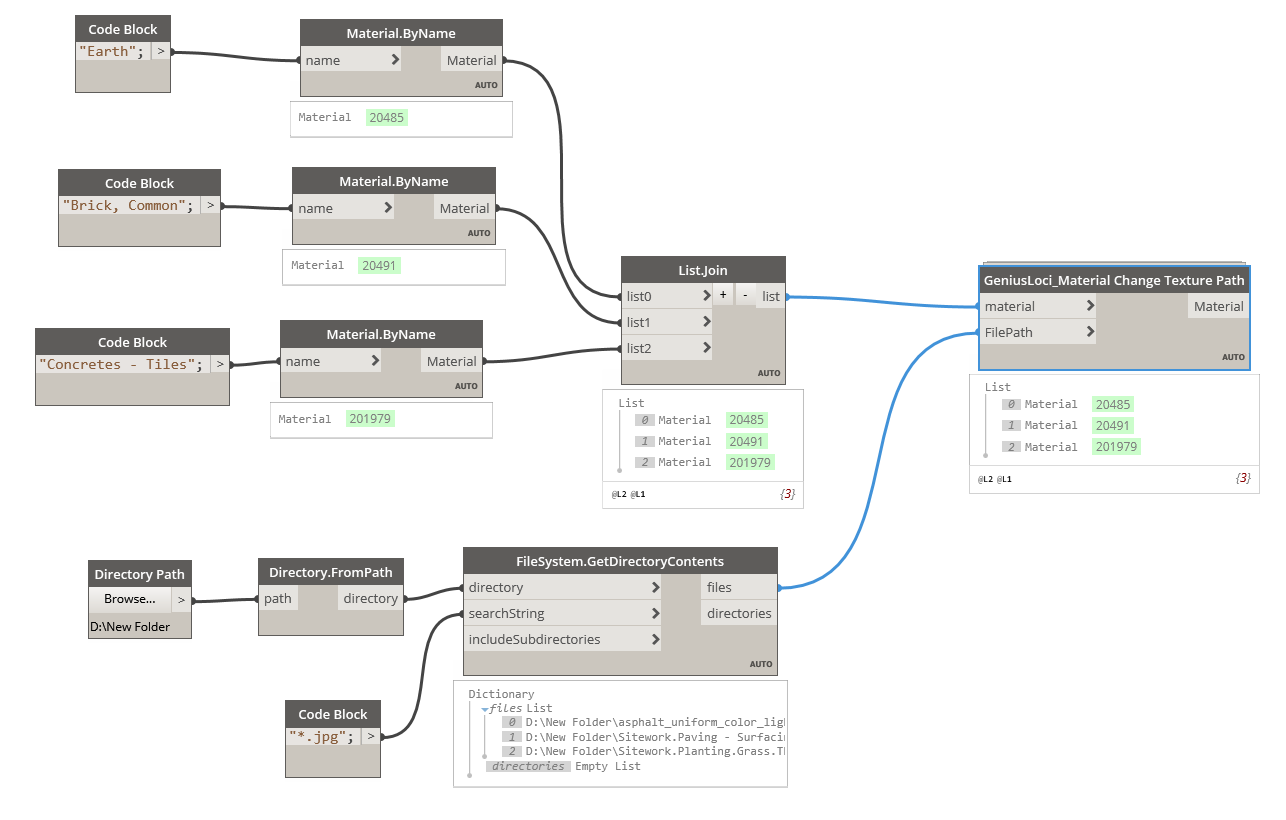

I created a new node for this task which works with all the materials schemas (masonry, wood, generic…) :
PS : Please note that this can take several minutes to calculate.

image I see this node, how does it function?

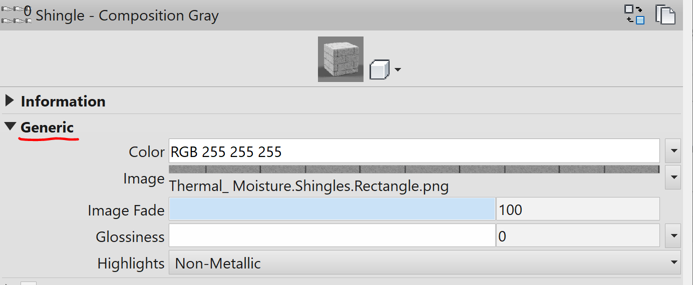

For now, this custom node only works with generic shemas materials but since I found a way to iterate over all the schemas in the Material Find Texture Path node, I can improve it if you need.
Generic schema :

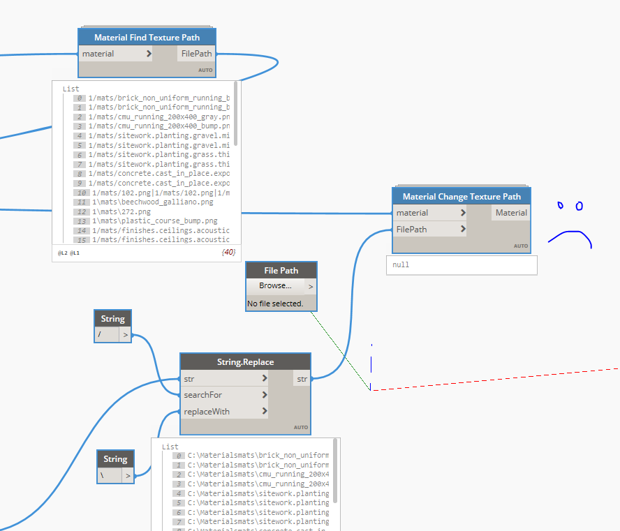

if you could do that, it would be amazing
I updated the Change Texture Path node and it should work with all the materials schemes now.
