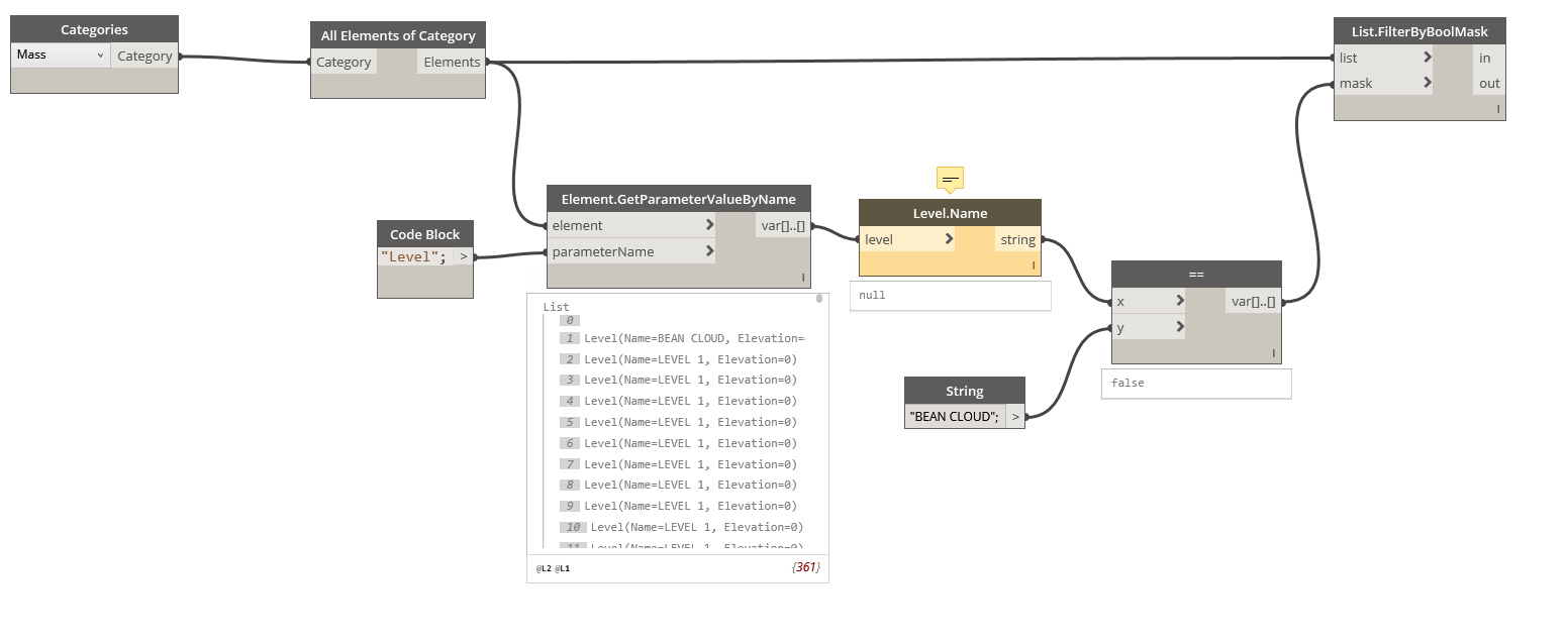

Mass_Level Filter (BoolMask)
It seems easy enough, but cannot get this Dynamo to get parameter value (“Level”) to show up correctly… “Level.Name” does not seem to be working…what am I missing?
I am trying to get the names of Level for the Mass placed in Revit Project… and furthermore Filter them by level…
thanks in advance!
hi @jkim
please check the first entry of your list of Levels (element 0 of the list) , it is empty that is why you are encountering an error/warning. remove all the Null and empty entries and you will be fine.
-biboy
Hi @jkim
Here is another possible way to filter regardless if the list contains empty or nulls:
that worked!
thanks guys!!
