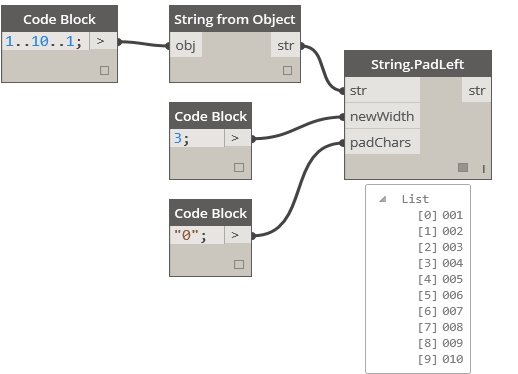

the other question is, that i want to add a running number to my key. i checked the Enumeration of th dynablaster package, but the same Problem is here. How should i deal with this Problems? i want to add the running number as well into my key (0001, 0002, 0003 etc.).
:slight_smile:
Use “String.PadLeft” node to add 00.

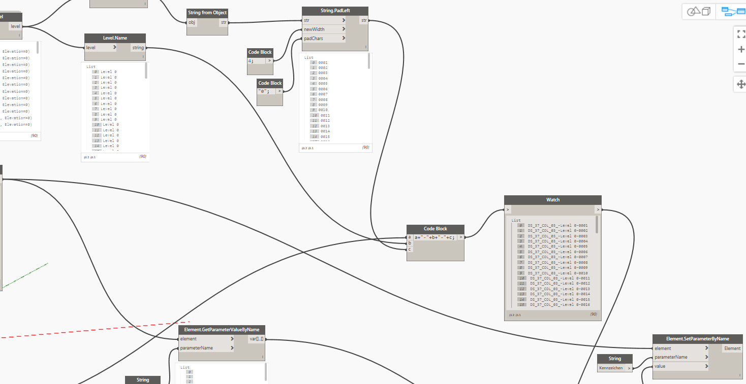

@Kulkul , thanks it works for the list. Do complete my solution i have to solve two more things. I Need to add the generated Level Information and the generated counting number to my string.concat to push this individual key to each instance in my model. how can i do this?
i attached my script and a screenshot.
thank you!
@Daniel_Woodcock1 : do you have also some ideas to finish my script? :slight_smile: Parameter_10.dyn (45.0 KB)
Hi @Balko,
Just use a code block and inside it write a + “-” + b + “-” + c this will concatenate strings together with a “-” as a separator.

@Daniel_Woodcock1 , yeah, we are close to finish now :slight_smile:
how can i flatten the Level list , i just want the number of the Level withour “Level”. the second strange Thing is, that my Dynamo crushes down, if i will do another copy in the *.dyn to add my key for another categorie, such as “walls” with the same code…

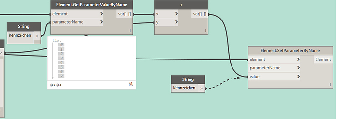

[[quote=“Daniel_Woodcock1, post:11, topic:8911”]
However, make sure the list of Elements and the list of parameter values is in the same list structure or you will get undesirable results
[/quote]
@Daniel_Woodcock1
I tried to take care about your advice concerning the lists. But i cant see the Problem actually in this script. Dynamo crushes down if i fill out the parameerName in the “Element.SetParameterByName” Nodein the wall Group. I collect to Groups of elements, walls and columns, so it should be no Problem to fill out the same Parameter “Kennzeichen” in the ID Goup Parameter Group.
i also tried to collect the´geometry with a python script to filter the different categories out of it, but it crushed also.
I attached the script for Information.
Test.dyn (49.8 KB)
