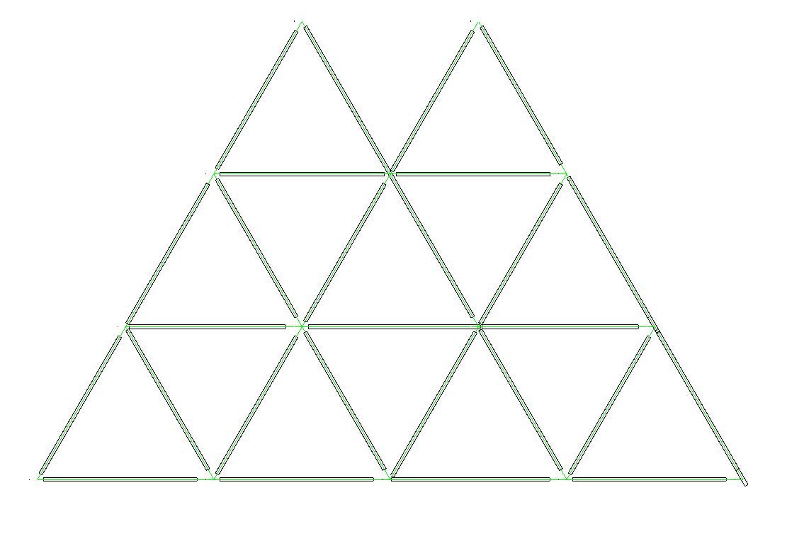

I’m trying to model a celing structural frame only to sketch the model lines in the model;
The proplem is that i can’t manage the junction of the structural frame (see picture)
another problem is that i would isolate the points of each triangle to make a hangers above of this, but i tried to do by “end curve point” but i don’t know why i find other points in the lines.
To address the first issue, you will need to place structural connections (I just started looking at this feature):
http://help.autodesk.com/view/RVT/2017/ENU/?guid=GUID-14D5F295-680A-440B-848C-847363BA0D06
There is also a Revit add-in for this:
For the second question, Curve.StartPoint gives me the points I expect. Some more details on your workflow could be useful here. See also on this topic:
Thanks,
but i I would only that my structural frame follows the model lines , and then i can manage the start/end distance. Is it possible? or maybe do I have to change element type?

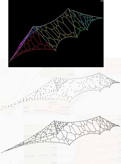

Here are some search results:
http://dynamobim.org/forums/topic/framing-element-overshooting-reference-point/
Springs.Beams.FixExtents from Spring Nodes seems to work for this…
if you’'re not using the steel material or scheduling it I found changing the material to concrete works well too (cheat the software). Your connections look fantastic and you get really great images and renderings.
