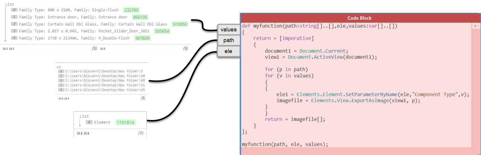

Hello, I am trying to now use design script, with a double FOR loop.
Of course, I am clueless of what I am doing… :frowning:
Anyone could give me some pointers here?
Here is what I got: you can see the source data, and what I have in the code block.
The two FOR loop need to be in parallel: in this case, 5 values and 5 paths should be used: a,a b,b c,c etc. forming 5 couples of data, not 25. Values and Paths should always be same depth lists, while “ele” should always be just one element.
Thank you!
regards
gio
