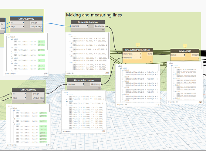

The goal of this script is to draw a line from all items within one index to all the items in another index, I’ve manage to get it working properly but it requires me to manually create and input the index that is required, this is both clunky and inflexible, is there anyway for dynamo to loop through the 2 list and draw lines between the corresponding index’s, as long as there are still index’s? any insight into the subject would be greatly appreciated, Thanks!

I have tried that but the lines drawn in that method are not correct, I managed to get the lines to draw correctly but this requires me to use the “List.GetItemAtIndex” node for each of the lists, is there anyway for me to accomplish the same result without making “List.GetItemAtIndex” node for each item on the list? Attached is my script taking a look at it may make what i’m trying to accomplish more clear

I think I narrowed the problem down to an error with the “Line.ByStartPointEndPoint” node that says “Unable to create line. points are likely coincident” I have the “Line.ByStartPointEndPoint” node lacing set to Cross Product but it is not lacing it like that for some reason, any suggestions on how to solve this error? any help would be much appreciated.
I’m guessing you need to use list levels. Are you wanting the points in both matching sublists to create lines?
I tried using both list levels and lacing but neither seem to work, yes i want to use the points in the matching sublists to create lines with Cross Product lacing, but when I use Cross Product it uses points from all sublists instead of just matching ones.
