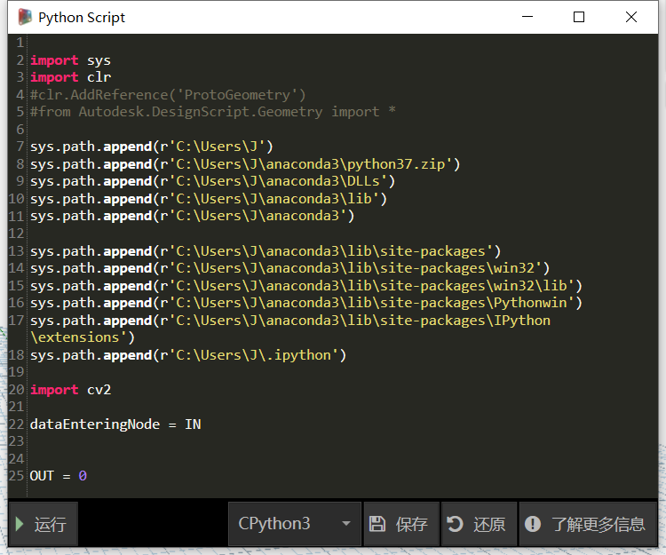

I was trying to load Python modules form Anaconda, by adding the path as shown in the image.
These modules worked fine under sypder.
I got this error when importing numpy:

Got this error when importing cv2:
ModuleNotFoundError : No module named ‘cv2’ [’ File “”, line 20, in \n’]
The modules you are trying to import have CPython dependencies which are not compatible with (or don’t exists for) IronPython.
the image above actually shows the CPython engine being used.
Dynamo now supports both CPython and IronPython.
problem solved through this link
