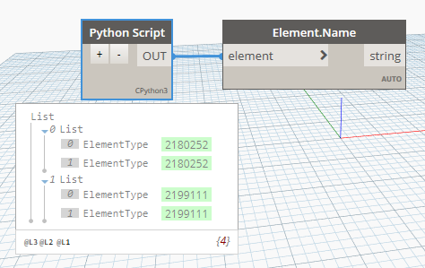

Hi @m.tradDBEVE ,
There is an OOTB (Out Of The Box) node in your Dynamo library called a “Python Script”. If you double click on the python script a python interface opens, in here you can copy paste the code @kennyb6 supplied to you.
With the + and - button on the Python script you can add more or less inputs as needed, in this case the script doesn’t need any.
