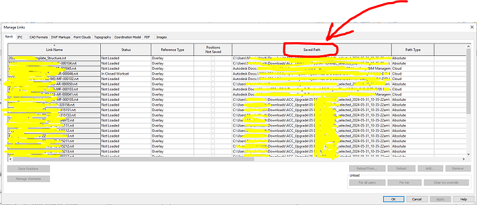

How to get the "Saved Path" of Revit Links into a list in dynamo
Hi, I’m trying to collect the Paths of each Revit Link into a list using dynamo that i can then export into an excel. is there a node in dynamo that can give me these paths as a list? or it only can be done through a Python script?

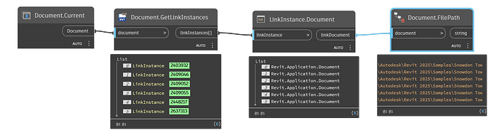

If you are able / willing to use Revit 2025 the below is now possible OOTB:
