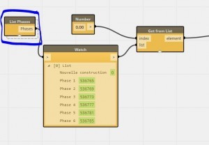

Does anyone know what happened to the ‘List.Phases’ node?
I am trying to control element phases and I can’t find an alternative, Any suggestions would be really appreciated.
Theres a node in the clockwork package called Element.Phases and Document.Phases. You just need to download them from the package manager.
