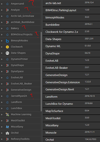

List of add-ons doesn't match installed packages
Left list is the add-ons.
Right list is installed packages.
How come they don’t match? Any idea how to find which one on the right relates to Ampersand?

I have those packages listed on the left. I can use them… However they’re not showing up in the package manager.
Bakery is another one that doesn’t show up on the package manager.
There is a match for each, but the names do not have to correlate. On such example: BIM4Struc.ParkingLayout = BIM4StrucProjects.
The section in the library does not always correspond to the name of the package, but this is something the pa algae author can configure themself. :slight_smile:
But whyyyyyy…
Because it makes it easier for package maintainers and authors to manage and for users to navigate. Case in point, for the package I released for the AU session Alexandra Nelson and I ran last year, we wanted three separate groups in the library, allowing loading and testing of any individual subset without impeding the larger environment.
