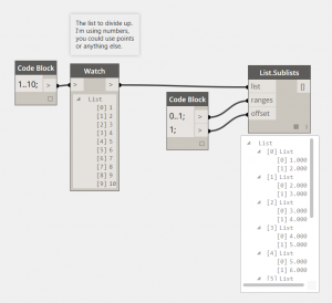

You are looking for the List.Sublists node. See this example, which does what you want it to do. Note that I’m using range expressions, which you can learn more about in the sample files.

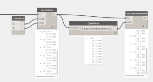

After this, since you want a series of lists with two numbers or points each, make sure you get rid of the last list, which only contains one item. To do this, one trick is to use a code block with a range expression… with the List.Count node called from insidethe range expression. The original list has indices from 0 to 9. Item #9 (which is itself a list with just one item in it) is the item you don’t want, and the total number of items in the list is 10, so by taking the elements of the list from 0 to (10)-2, (same as 0…8 but parametrically linked to the length of the list) you get everything in the list but the last item. Now all of your lists neatly have two elements in them.

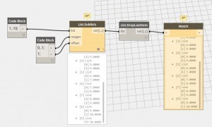

Or alternatively for the last part use the node list.droplastitem from the package manager
