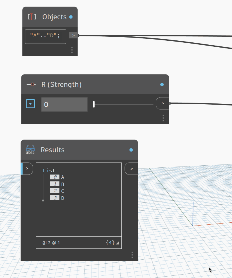

Using just Dynamo nodes, it seems possible. (I’m not a big grasshopper user so this node is new to me, but it looks/sounds awesome!)
GIF:
Graph Image:
Graph:
Jitter.dyn (24.8 KB)
@john_pierson Yeah, I think you did the same as I in pyton :). The difference between GH and this Jitter is that Strength range in GH is decimals from 0…1 I wonder if that changes anything
Oh interesting. Yeah you can definitely tie that slide to those values or even do a mapto on that R input as well.
