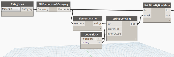

is it possible to filter the materials, so only those containing “random” gets used?
thanks :slight_smile:
/Jorgensen
Definitely! :slight_smile:
