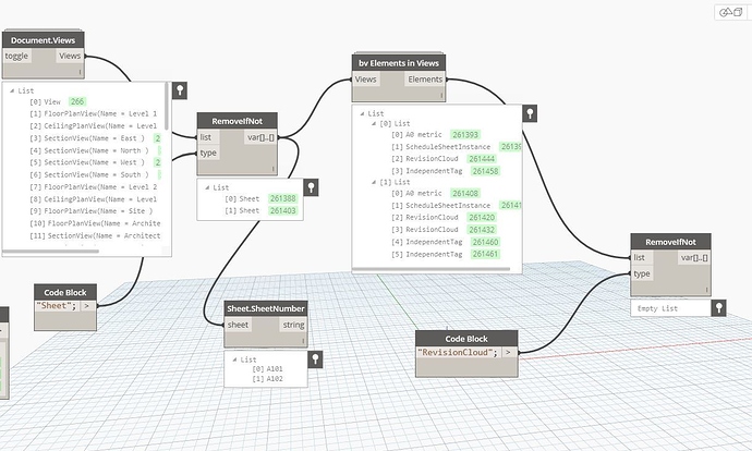

it seems easy to filter the first list, but somehow it doesn’t work for “RevisionCloud” or any other Strings…
the main goal i just to select all revisioncloud from each sheet.

Hi Yen,
You need to change lacing to longest to “RemoveIfNot” node.
I would also recommend looking at this post. Not sure what your end goal is but the script in there might be what you are trying to do.
Kulkul,
nope, i tried all the different lacing.

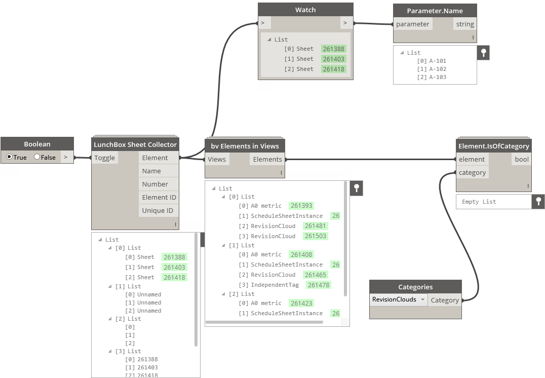

KULKUL,
somehow, my nodes doesnt works like yours…
Yien,

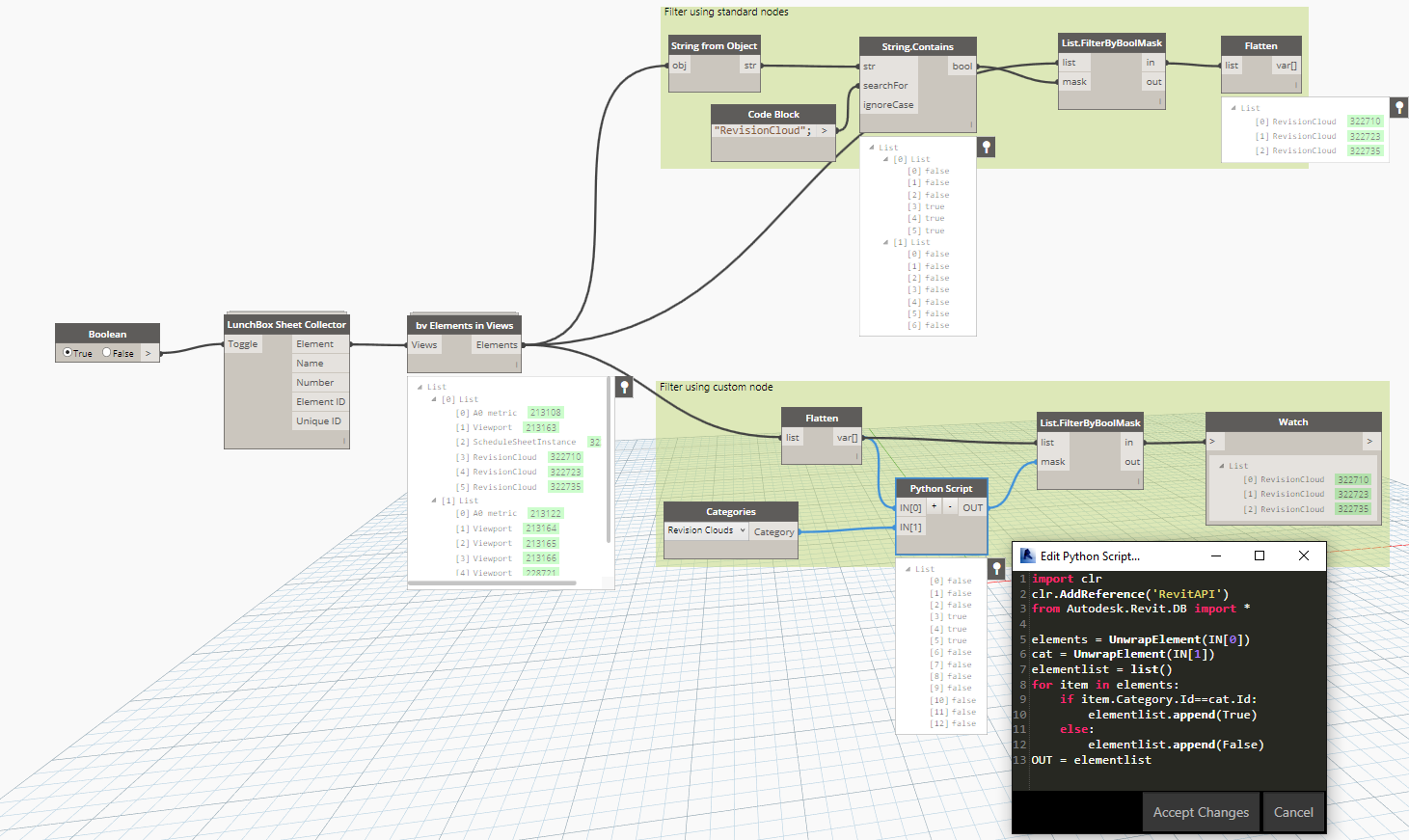

Below there are 2 methods shown to filter “Revision cloud”. You can use any of them. Good Luck!
nice! thank you KULKUL!
