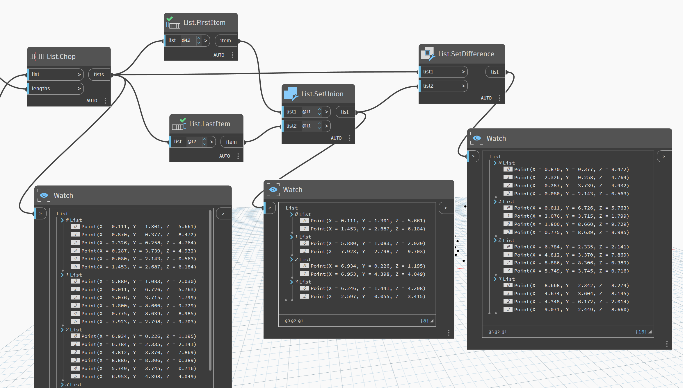

If it’s always the first and last, you can use something like this:
Cheers!
Most nodes will accept negative indices. A negative index means that you index from the end of the list instead of the front. Removing the indices [0,-1] will remove the first and last items for you.

That was my first thought as well, but since I was not sure about this node, I did a little test and it an it didn’t work.
Hola amigos, buenas. @VijayS your first thought was in the right direction, just needit a couple extra steps, create a new list and diference with the original i let you the example, but play with index is allways the best option!!

I tested this yesterday and I swear it worked for this node…
It does work for most index inputs. Not sure why it doesn’t work for RemoveItemAtIndex.
