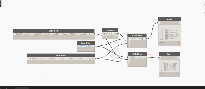

LISt and IF not working as expected
could you please tell me, what is wrong with this IF statement?

Hello
The reason of this behavior is :
The IF node replicates on all nodes AS THOUGH SET TO SHORTEST.
Greetings Nico
Hello ngochungwru and Adnan @adnandj
Here are some examples off the behavior off the ootb IF node.
I think the Python solution or ScopeIf+ from clockwork package is what you are looking for.

Not a bug, it’s just returning shortest lacing.
See these issues for background & solutions:
DynamoDS/Dynamo#7467
DynamoDS/Dynamo#6258
DynamoDS/Dynamo#6491
So use OOTB node ScopeIF:

It has nothing to do with being stable but the intent of the node… It is meant for another use than this, namely not executing up stream nodes… Failing to have completely separate tracks will cause dynamo to crash…

Hi all,
thank you for the feedback. I used Scopeif+ from Clockwork package.
