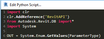

Is there any way to list all types of parameters as the Parameter Groups node of the Data-Shapes package already does? (attached image) I have researched and I have discovered that in old versions, with the nodes of archi-lab if that possibility existed, now you can only choose one at a time.

I guess this is what you’re after:
I borrowed the Python Script from the “ParameterGroup list” node (thanks Data-Shapes). And query for Parameter types instead (they do however not come out alphabetically, therefore the Sorting.

It is exactly what I needed!
Thank you so much!!
